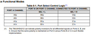

we are using the TMUXHS4212 to select the input source for a USB3 client and for better routing we would like to swap P and N on the A0 port. Normally this should not be a problem with USB3, but how does the B0 or C0 port behave when connected normally or do I also have to reverse the polarity of B0 and C0?
Another Question: Can I connect OEn directly to gnd? (without resistor)
