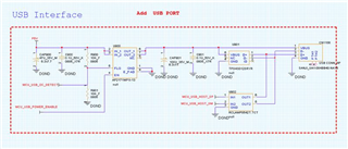

I need your assistance to confirm whether the schematic for the TPD4S012 is correct.
Hi Sky,
I am a bit confused on why the RCLAMP is being used before the TPD4S012. They are both protection devices. If you need to protect more channels, then we can find a device that has that option for you.
McKenzie
Thank you for your reply.
So based on your suggestion, I only need the TPD4S012 to complete the ESD protection for USB. Is that correct?

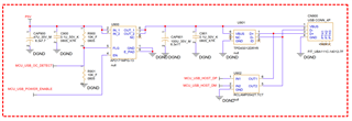

Hi Sky,
Would you be able to share more of the schematic so I can see what the RCLAMP device is connecting to? Being able to see the bigger picture will help determine the best recommendation.
McKenzie
Hi Sky,
So based on what I am seeing, it looks like the RCLAMP device and the TPD4S012 device are in parallel. That isn't ideal and will add more capacitance into your system. There are a few options:
1. Remove RCLAMP device, then GND the ID pin on the TPD4S012 device so the pin is not floating.
2. Remove RCLAMP and TPD4S012, then have one device for VBUS protection and one device for D+/D- (I can give you TI recommendations if needed).
Are there any specific requirements needed for protecting the MCU?
McKenzie
According to what you mentioned in point 2, could you provide me with TI's recommendation?
The MCU doesn't have any special requirements.
Hi Sky,
Yes, I would recommend ESD441 for VBUS and ESD122 for the D+/- lines. Here's a good application note on USB ESD protection: link.
