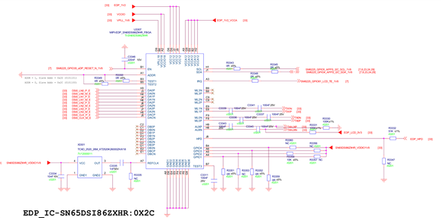

    We met i2c error when we read EDID of NG device,and found the device has no ack. We catch the wave and find the AUX P/N are swapped on NG device compare to the Normal device.Could you please tell us how to swap AUXP and AUXN by setting registers of DSI86?
    Also, as you know,we can get EDID on one project and can't get it on another project,Could you have any debug way?
    we find sometimes the 0xF4=9 and 0x78 send bit can't be clear.
  • Hi Ikram,
    We've just tested  the Tcon code that it swapped the AUXP and AUXN can get the EDID.
  • Hi Ikram,
    Could you please help us check why  AUXP and AUXN has swapped and how to swap them by set registers of DSI86?
  • Hi Haibin,
    1. Could you share the waveforms of what is captured and how they are different between working and not-working boards? Please also share the schematic, including AUX channel throughout the link. Please check AUX channel components and connections for both this device (source) and sink (display/ receiver).
    The AUX connections should be set according to DP/eDP implementation on both source and sink schematics.
    2. In the not-working boards, what are the issues seen currently?
    Are all the boards built identical or is there any differences such as different display, different eDP/DP sink, etc?
    3.SN65DSI86 can only swap the polarity of the data lanes, not the aux channel. So there is no register setting to invert the polarity.
    Ikram
  • 1.Above is the NG and OK waveforms.
    Below is the schematic,
    ---->The NG board can display normal,but when I send the read EDID commands,the dmesg log show the device(0x50) has no ACK。
  • Hi Ikram,
    Sorry,I can't upload the all pictures because my pc can't work well.
    I'll upload the NG waveform after my PC can work again.
    The NG waveform is opposite to OK waveform,that means the voltage level is high on the OK waveform but it is low on the NG waveform.
  • Hi Ikram,
    From the typical application, why AUX_N of the Figure9-2 1080P  panel doesn't need the pull up? Our project is also the 1080P panel and AUX_N is pull up 3.3V.

    Is your panel a DP or eDP configuration? That would determine which components (AC-capacitors, pull-up and pull-down resistors) are required for the AUX channel. The Figures 9-1 and 9-2 from the datasheet are different for DP and eDP implementations.
    On the DP/eDP sink (display) which received the DP main link and AUX, what components are added there? Please share that portion of the schematic and the waveforms for NG cases.
    Thank you,
    Ikram
