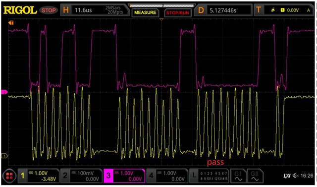

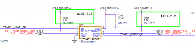

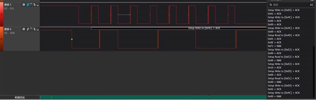

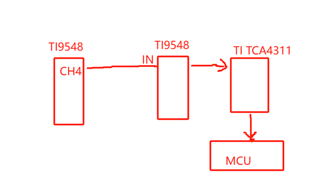

My customer is using TCA4311 in their system paired with TCA9548. They meet the "I2C write failed" issue in their system occasionally w/ TCA4311.
Issue signature:
TCA9548+TCA4311 connection:
With TCA4311, the waveform of passing and when failed:
pass:
fail:
If they remove TCA4311 and connect SMBUS, there will be no write fail problem.
Why does TCA4311 affect the operation of the SMBUS bus?
