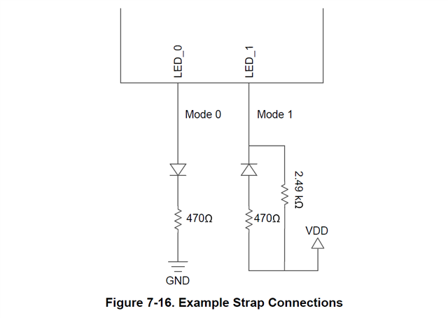

    Note that for LED strapping there is a special configuration of strapping to be done to ensure that the PHY straps to the desired configuration and the LED properly works. Below is the reference:

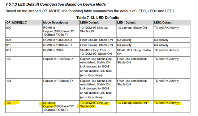

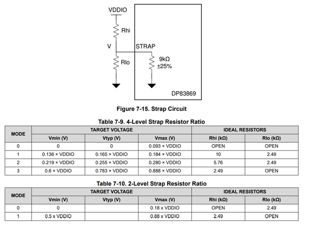

    2. What should be the strapping method and resistor values for the below pins on the PHY to support SGMII(or 1000Base-KX) to 1000Base-T conversion, LEDs to indicated 1000Mbps link and activity.
    For SGMII to copper,
    The following pins are needed and will be in two level strapping so mode 1 corresponds to this:
    1. RX_D2(pin 35) - mode 1
    2. RX_D3(pin 36) - mode 1
        JTAG_TDO/GPIO_1 - mode 0
    For fiber to copper media conversion, the following pins are needed in strapping options as such:
    2. RX_D3(pin 36) - mode 0
        JTAG_TDO/GPIO_1 - mode 1
    For 1000Mbps link and activity, sgmii to copper defaults LED to the highlighted:
    Please note that LED strapping configurations are for auto-negotiation, not LED settings itself. To modify from the default LED setting, you will need register access.
