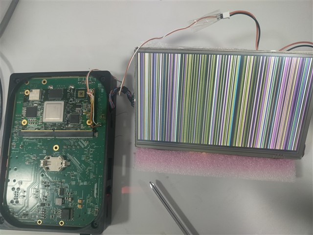

We are working on QCS615 processor with 6.6.52 Linux kernel, and our custom hardware have DSI to LVDS bridge(sn65dsi84) support, we are facing LVDS bring-up issue, where we see some noisy RGB lines on the LVDS display.
Software details:
Linux Kernel: 6.6.52
Processor: QCS615
Bridge: SN65DSI84ZXHR
LVDS: ATM0700L6L
  1. Attached the dts file changes for reference. (qcs615-custom.dts)
  2. Used "ti-sn65dsi83.c" bridge driver and enabled the driver in defconfig file.
  3. Used "panel-simple.c" file to pass LVDS timing parameter. (https://github.com/nxp-imx/linux-imx/blob/lf-6.12.y/drivers/gpu/drm/panel/panel-simple.c) and updated the timing as per our LVDS. (LVDS-timing-paramet-passed-through-panel-simple-driver-file.txt)
  4. Attached the boot-log for reference. (SN65DSI84.txt)
  5. Attached the LVDS datasheet for reference. (ATM0700L6L.pdf)
Request your support in this

  • Hi Shwetha,
    Is this driver provided by TI? The only driver support we could share is linked in the previous thread: https://e2e.ti.com/support/interface-group/interface/f/interface-forum/546145/question-about-sn65dsi84/
    For the DSI bridge initialization/configuration sequence, please use this guide: https://www.ti.com/lit/an/slla332b/slla332b.pdf?ts=1744759679816
    And you can download the DSI tuner tool from here: https://e2e.ti.com/support/interface-group/interface/f/interface-forum/825302/sn65dsi83-dsi-tuner-tool-needed
    Ikram
