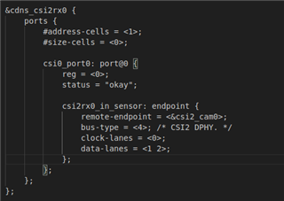

  • hello Lucas Wolter:
    I using an EVM for the 960 called "fustion board" . and chip in fusion board was "TDES960"
    Here is the  Sensor "Imx219" line register. I choose the line number to 2line
    /* imx219_configure_lanes start */
    IMX219_REG_CSI_LANE_MODE, 0x01,//Set the CSI line to 2 TBC (0x01)
    I read the register period. It seems that the frame H-total and V-total count error. It changed every time read  the register. and the 0x90-0x93 is 0 all the time. Seems that the 960 have receive video but some error appear there.

    By the way. here is the csi rx setting dts in SOC:

    • It looks like your SoC is expecting 2 data lanes. Register 0x33[5:4] is currently configured to use 4 lanes. Please change this register value to configure 2 lanes.

  • Hello Lucas:
         I update the CSI in device tree. set the lane to 4 line and let the frequency below
  • Hi Meng,
    Just to confirm, did updating the DPHY lane configuration at your SoC to 4 lanes resolve the issue? The SoC now receives CSI-2 data correctly when pattern generation is enabled on the 953?
    If this is the case, then I believe we can move on to debugging CSI-2 errors at the 953. Can you share the layout file of your 953/camera board? I'd like to check for any possible issues with the CSI-2 traces.
    Lucas
