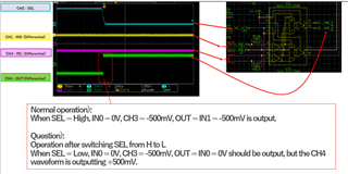

We are currently evaluating the SN65LVCP22 used as a 2:1 LVDS crosspoint switch in our system, and have observed unexpected output voltage behavior during SEL switching.
Configuration:
  • Device: SN65LVCP22
  • Usage: 2:1 LVDS switch (IN0 or IN1 to OUT based on SEL)
  • SEL = High: IN1 → OUT
  • SEL = Low: IN0 → OUT
  • Both IN0 and IN1 receive AC-coupled LVDS signals from other devices.
Observed Issue:
When switching SEL from High to Low to route IN0 to the output, we observe +500mV at the output even though IN0 is at 0V (no signal).
However, when both IN0 and IN1 are at -500mV, switching SEL results in the expected -500mV at the output.

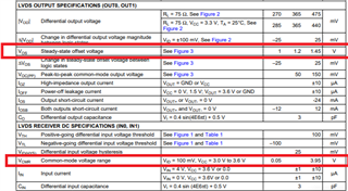

  • HI Conor:
    1: if you send any AC signal to IN0 and IN1, dies device working as expected?
    2:for IN signal, min DC common mode volatge is 50mv, so 0v DC is out of datasheet spec..
    Best
    Brian

  • IN0 /IN1 in scope is single ended or differential signal?
    IN0  seems  0v., is it?
    Brian
  • Hi Brian,
    IN0/IN1 on CH1 and 3 are differential signals. As you know, IN0 is 0V.
    The image contained some Japanese text, so I am sending you the corrected version again.
    As stated in the image, what we would like to know is, "When SEL = Low, IN0 = 0V, CH3 = -500mV, OUT = IN0 = 0V should be output, but why is the CH4 waveform outputting +500mV?" Please answer, including whether this behavior is expected of the IC.
    Conor
