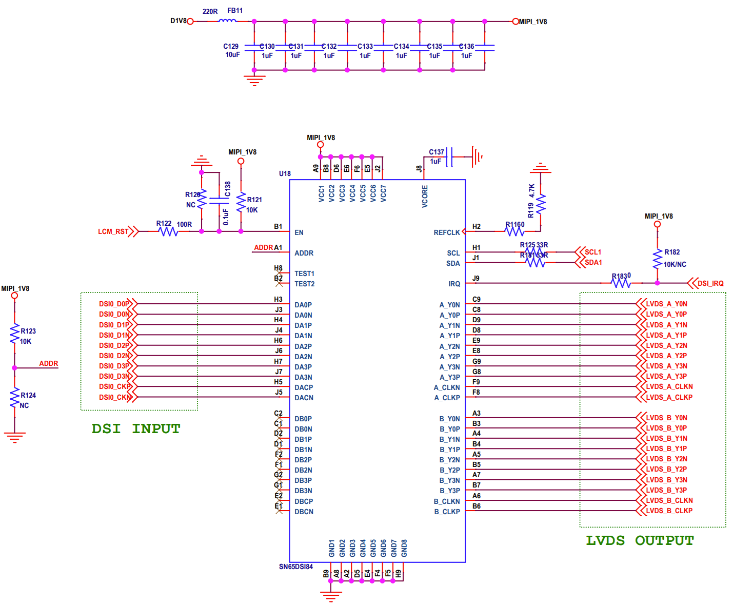

SN65DSI84: The SCH review
Part Number: SN65DSI84
Hi E2E,
PLS help review the SCH of SN65DSI84:
