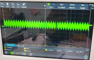

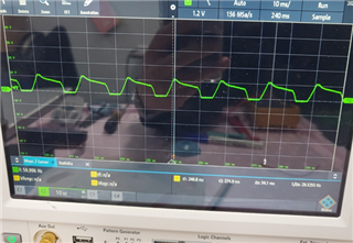

1. System diagram.
2. Symptom
Normal: When the Earth (PE) is connected to the PC, the network is normal.
Abnormal: When the Earth (PE) is not connected to the PC(laptop), the network is not work.
3. Related Question
Below is a link to a forum post about the same issue we are having right now.
TS3L501E: I need to connect the system GND to PE - Switches & multiplexers forum - Switches & multiplexers - TI E2E support forums
Normally, the laptop does not have PE connected, only LINE/NEUTRAL connected.
I wonder if there is a solution for this case.
