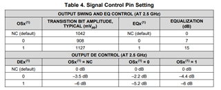

SN65LVPE502A is NRND and TUSB522 USB3 redriver P2P but will the settings be the same?

The values will not be the exact same:
