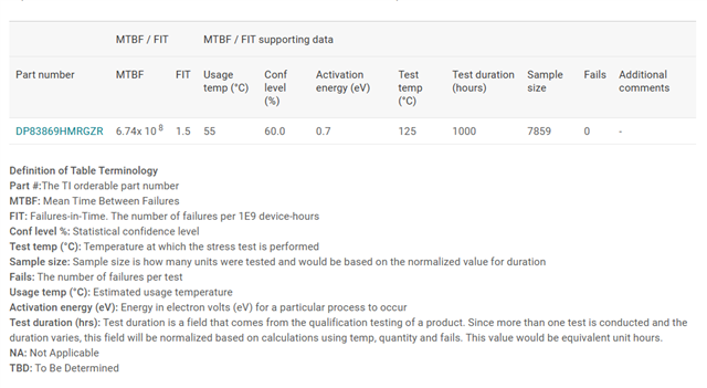

I inquire about the functional safety FIT(Application FIT Rate) value and failure mode distribution, Gate scale for DP83869HM.
Standard is SIEMENSE SN29500-2.
(it is not a request for a JEDEC-based technical fit value.)
PART NO.
DP83869HMRGZT
