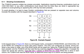

1) "TCA8418 I 2C Controlled Keypad Scan IC With Integrated ESD Protection" page 37 has this statement below:
In the keypad setup in Figure 26, there is a 4x3 keypad matrix, connected to ROW0-ROW3, and COL0-COL2. All of the ROWs are configured as inputs with pullup resistors. The COLs are configured as outputs, driving low. When a key press is made, one of the ROW inputs will be pulled low, letting the TCA8418 know that a key has been pressed, and the TCA8418 will then start the key scanning algorithm. During this algorithm, It sweeps the output low across the columns, such that only 1 column is driven low at a time. While this is done to each column, the TCA8418 will read the ROW inputs, to determine which keys on a column are being pressed.
So, in the idle connection we have our ROWx pins HIGH, pulled-up internally and COLx pins LOW.
After pressing a key, a ROWx pin should be pulled LOW.
Then, the statement tells us the IC will execute a "sweep" the output low for the columns, but don't they have all LOW signals? What's the meaning of this? How could IC tell which button is pressed in ROWx?
2) ROWx is pulled-up in the idle scan connection. So, how pressing a button make a pull-down or a LOW signal happen there? I couldn't understand the ROWx-button-COLx relationship. Could anyone elaborate?

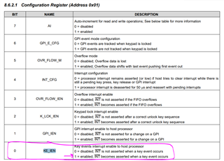

The current setup of ours works like below:
Pressing a keypad button doesn't change ROWx status, all rows stay HIGH.
COLx goes HIGH.
No scan occurs.
INT stays HIGH all the time.

    1. The datasheet says that "only 1 column is driven low at a time". When a row input is low, the pressed key must be in that column.
    2. Pressing a key connects the row to the column. With a weak pull-up resistor and the COLx output strongly pulling low, the result is low.
    The key is that only 1 column is driven LOW at a single time. It sweeps each COL individually not all at the same time.
    COLx goes HIGH.
    No scan occurs.
    A Row is connected to the Col pin via a switch that is open-circuit.
    If a ROW is weakly pulled-up HIGH, and a COL is driven strongly LOW, the COL pin output will pull the weak ROW input down when the switch press connects the ROW to COL. ROW and COL will be the same state when the switch is pressed.
    When the switch is not pressed, the ROW is input w/ PU resistor, so the ROW pin is HIGH logic.
    The COL is output LOW, but since the switch is open-circuit, the ROW input stays HIGH logic meaning the switch was not pressed.
    Ensure that KE_IEN = 1 for interrupt to be asserted on /INT when a key event occurs.
