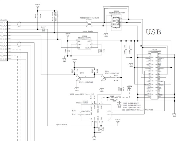

TUSB320LAI: When set to DRP, the device connection cannot be detected.
Part Number: TUSB320LAI
Other Parts Discussed in Thread: TUSB320
When I entered ”H” into PORT and set it to DFP, the device connection was detected.
When I left the PORT open and set it to DRP, the device was detected immediately after turning the power on.
However, if I connect a device while the power is on, it cannot be detected.

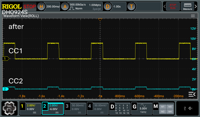

CC1/CC2 continues to output an H for about 184 ms and an L for about 334 ms.
What could be the cause?
The I2C terminal is open.
