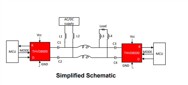

I am searching for the solution for RS485 with power delivery.
More specifically, I need to use 3 -wires to carry the data and power at the same time.
I found THVD8000 could carry RS485 on power, but when I see more deeper and someting confused me.
Is that measns if I use RS485 communication on A,B, the power could not delivery and needs another nodes for self-power providing?
Otherwise, if use OOK modulation and the power(might 3V or 5V) could carry on these A,B wire?
Please help me to clarify or any suggestions are welcome.

    The THVD8000 is called Powerbus which is OOK modulated RS-485. The THVD8000 doesn't carry power itself - it is purely data. However, why you use this in power line communication is that you can essentially place the data and power onto the same pair of wires with a proper coupling network - allowing power and data to be conducted over a single pair of wires between system nodes.
    The example Clemens shows is a good example where the power is an AC signal fed to a rectifier and LDO - however you don't need the LDO or rectifier in every example - this is just one example. A more generalized example is shown below:
    Essentially the power supply and data are coupled onto the same pair of wires and are decoupled when they reach respective loads.
    C1 - C4 will allow higher frequency OOK data through without much attenuation but will block DC and greatly attenuate low frequency AC (50/60 Hz).
    L1 - L4 will allow power signal through without much attenuation but will attenuate the higher frequency OOK data - it is assumed that there is bulk capacitance on the supply and power loads - if these are not present you may see OOK noise on the load/supply - for DC systems this usually isn't a problem because DC power supplies typically have bulk capacitance already - but AC supplies don't necessarily have that so some extra filtering may be needed in that case.
    One note is that you can have more than 2 nodes - the simple examples just typically show 2 nodes.
