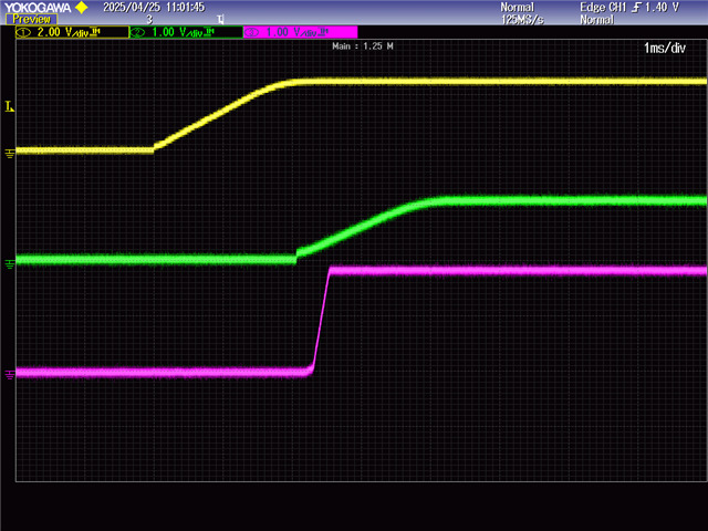

    Attached is power sequence. VDDA1P8 pin is open because the customer uses the device with two supply configuration.
    It's difficult to check all PHY addresses because software is running.
    RBIAS voltage was 1V for both normal unit and defective unit.
    CH1:VDDA2P5
    CH2:VDD1P0
    CH3:VDDIO(1.8V)
    Shota Mago
  • Hi Mago-san,
    And the reset pin is low throughout the power sequence? When does the reset pin go high?
    J
  • Hi Mago-san,
    After internal discussion, it would be great if the customer could run all the PHY addresses after the startup of the problematic PHY to see if the PHY is strapping to the wrong PHY address. Could you try to convince the customer to do this?
    The power sequence looks good.

  • Hi Mago-san,
    I reviewed the waveform and I noticed that the RESET_N unintentionally goes up to 1Vish for a bit. Because Vih is 1.26V so the pulse shouldn't affect the RESET stage but it may due to the slow ramp up to 1V. I'd assume the customer uses the same logic device for all the boards with our sample. Has the customer noticed the same pulse on other boards with our sample?
    It would still be great if the customer can test with all PHY addresses to see if they can MDIO access with the problematic PHY.
    I reviewed the schematic, and there is nothing notable either. Another thing I can think of is that the oscillator the customer uses is out of our recommended specification. Could you also check the oscillator specification with the customer?
    Please let me know.
    J
  • Hi J,
    The customer confirmed that the pulse on RESET_N occurred at correct samples as well. He fixed the pulse, but the MDIO issue still remains.

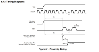

    When does the PHY read strap setting? The datasheet states it latches hardware configuration pins at power-on or reset, but the customer would like to know more details like as follows.
    1. At what timing of the hard reset (falling edge or rising edge, and timing)
    2. When does latch occur(How long ms after which power supply turned on)
  • Hi Mago-san,
    I understand that ABA swap might be challenging.
    Please refer to this chart for the timing of strapping:
    Given that XI is provided prior to power-up, strap latch in happens 200ms after the VDD and RESET_N going high.
    I discussed internally with the team and we believe that customer should be able to see any changes on RXD0 and RXD2 pins when the PHY properly straps and when the issue occurs. Could the customer take waveforms of RXD0 and RXD2 pins when the issue occurs and in the normal state to see what that change could be?
