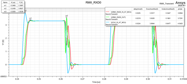

We have simulated the IBIS model RXD pin as output and seen this behavior at the output of the driver.
Please let us know why this is happening

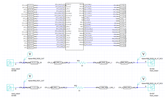

Could you please provide the test bench used? A picture would be sufficient.

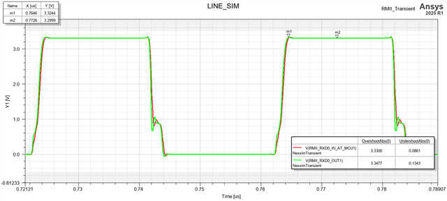

I want to request a sanity check on the model to rule out unintentional loading by the receiver. On the RX_D0 line, could you please insert a 5pF load to GND instead of the receiver? It is unclear how this specific IBIS model was characterized due to the long lifespan of the part, but in newer IBIS models (DP8382x family, DP8386x family), this is the typical test bench. If this falling edge is clean, this would lead to impedance mismatch in your application instead of issues with the IBIS model.
