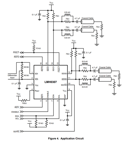

Dear Team,
My customer is looking for a device for three HD-SDI/3G-SDI outputs.
When they look at the datasheet of the LMH0307, the application circuit appears to be capable for four outpus.
Can they use the LMH0307 for three HD-SDI/3G-SDI outputs?
If you have any other solutions, please let me know.
Koshi Ninomiya
  • Hi Ninomiya-san,
    LMH0307 supports two 3G-SDI outputs. I do not believe we have cable driver that supports three outputs. The customer could implement one LMH0307 and one LMH0302 to drive three outputs, however.
