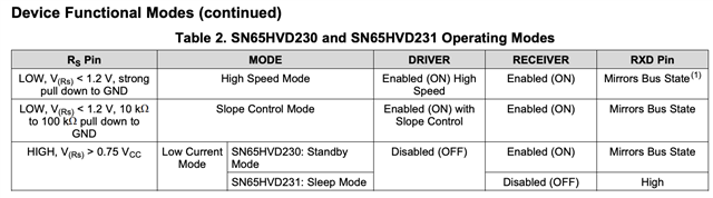

We found that when the CAN transceiver was installed in parallel with the 1439 and the 1439 was enabled (RE=0, DE=1) and the 65HVD234 was disabled (?) with Rs=1 and EN=0,  the data line shared by both devices had data that was present but never reached below 1/2Vcc.  We could understand that the 485 data on D+(CANH) and D-(CANL) might be affected but the item affected is the output of the 485 that is attempting to drive the data line.

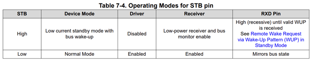

I suspect that placing the CAN transceiver in what we think is a disabled state still has the driver on pin 4 (R) enabled and is high so prevents the 1439 from being able to pull data to ground.
Can you recommend a CAN transceiver that disconnects the data side when disabled and has low power consumption. Standby listen is not required.
