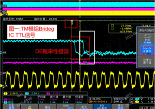

My customer use SN75LVDS84A and THC63LVDF84C as RGB to LVDS and LVDS to RGB bridge to screen.
We meet a issue which is DE signal jitter , some time DE signal include more one clk. some time not.
They probe the THC63LVDF84C DE output. But they do the ABA test, we found the issue is follow the SN75LVDS84A.
So do you have some method to check if the LVDS output is correct?
We also probe the DE signal input in SN75LVDS84A, which is good no jitter.
DE at SN75LVDS84A input.
DE at THC63LVDF84C output:

  • Hi Ikram Haque
    The waveform is from THC63LVDF84C. So you can see the first is good board. second is bad board. Which have random lower edge, jitter about 1 clock width.

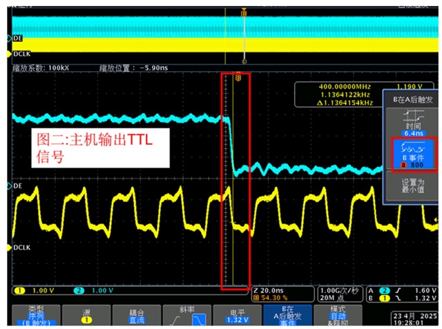

  • The complete video signal link is the CPU output RGB signal converted to LVDS signal via the SN75LVDS84ADGGR. Connected to the screen end via a screen cable; the screen end has a bridge chip THC63LVDF84C, which then converts the LVDS signal into an RGB signal output to the driver IC of the screen.
    1. How is the waveform being captured? Is this edge-triggered and with persistence on? Could you tell us how they are trying to measure jitter here?

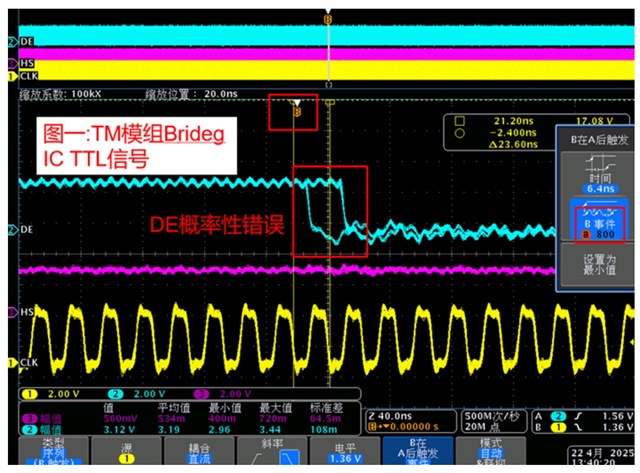

    Condition triggered, DE rising edge start is event A, CLK falling edge is event B, screen resolution is 800*480, The anomaly is that the bottom line of pixels on the screen displays erratically and flickens. So the trigger time is set to 800, and this is persistence mode open. The normal display should be only one  DE down edge, and an anomaly display will more one clock for before DE signal.
    Bad DE at THC63LVDF84C output:
     2. The first is the SN75LVDS84A input, which should be good in both working and not-working boards. Could you share the "DE at THC63LVDF84C" for good and NG boards?
    Yes , SN75LVDS84A input looks good.
    The board of the NG will contain an additional clock sometime because persistence mode we can see two down edge , like the white box in the figure.
    good board not.

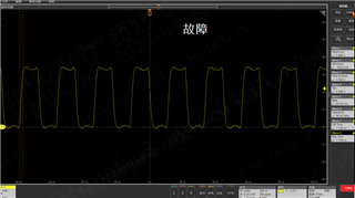

    3. What is the frequency of the issue? How many boards tested and how many show this issue? And do the NG boards always show this?
    10% NG not only one.
    If this is occurring on many boards tested, then this could be a system design issue rather than issue with the part itself. Also, what is the PCLK rate?

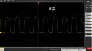

    PCLK = 44.44Mhz in both normal and anomaly case. same waveform we see.
    bad :
    good:

  • Thank you Yuxi,
    Are the "DE at SN75LVDS84A input" measurements also with persistence on and it always aligns this way with the input clock? It would help to check whether there is any misalignment from the SoC/ source side.
