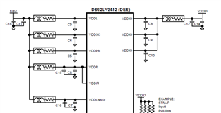

In addition, they have implemented countermeasures recommended in the datasheet, such as noise isolation on the VDDPR line using beads and capacitors; however, the issue has not been resolved.

    The customer followed the instructions in the "Related Questions" section and decoupled with beads and 22μF, 0.1μF, and 0.01μF, but the situation did not improve. Therefore, we believe that the unlocking of the defective product is part-specific and temperature-dependent.

    1. If possible could you share the schematic of the DES, so we can check that all the necessary external components are added.

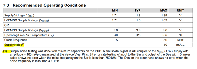

    2. Can you also ask the customer to measure power supply noise for both SER and DES. The datasheet has a description for this. I am suggesting this because this issue is occurring at lower frequencies.
