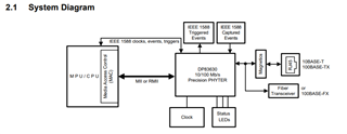

Hi Team,
customer got a case need 1588 and SYNC-E, and seems DP83630 can meet this requirement
Can you please check the diagram for us
 Is that ok for DP83630? if not, could you suggest us any solution? thanks for your help and learn from you,
  • Hi Tommy,
    DP838630 doesn't support RGMII. You will need to use either MII or RMII between the CPU and DP83630 in this application:
    This device can accept and output a 1588 clock. Additionally it can be programmed to output a PPS signal:
    If the customer is ok with using RMII or MII this device should work.
