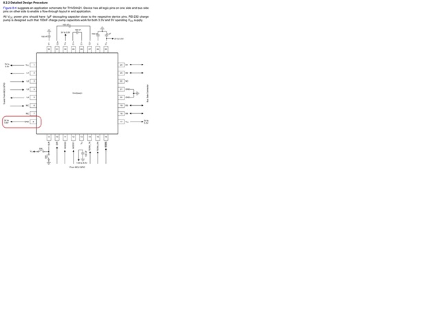

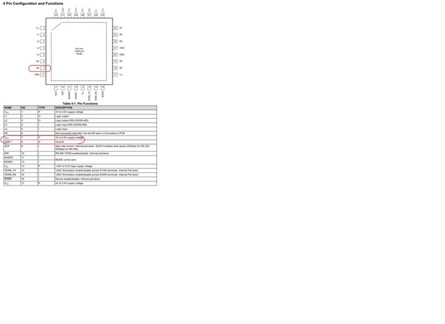

Regarding the THVD4421 problem, please refer to the following diagram
1. Is Pin7 an NC pin or a Vcc pin (Figure 1)?
2. Should Pin8 be connected to GND or 3V to 5.5V (Figure 2)
    The picture ABOVE table 4-1 is the correct one. Pin 7 is NC.
    GND, please do not connect this to a power rail.
    Thanks for bringing this to our attention, I will submit a change request for this.
