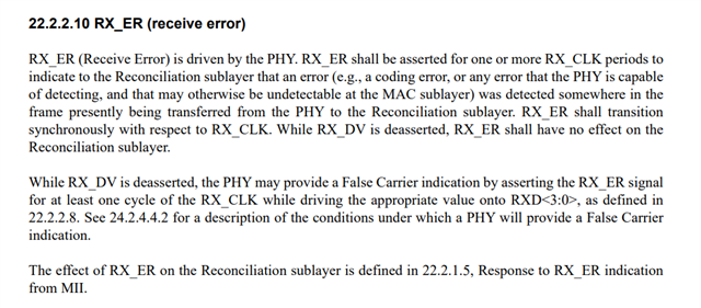

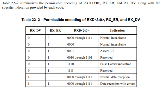

Hi Team,
In RGMII full-duplex mode, regardless of the speed, will the RXERR (the error bits output from the PHY) and TXERR (the error bits output from the MAC) never be asserted?
If they are asserted in full-duplex mode, please give me a specific example.
