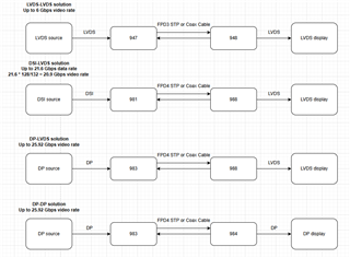

  • Hi E,
    If you are looking for a serializer that takes in LVDS data, and a deserializer that outputs LVDS data, then I would suggest the DS90UB947/DS90UB948. These devices can support up to 6 Gbps data rate.
    LVDS data by using only D0, D1, D2 lanes and not connect the D3, AUX, HPD
    This is fine.
    The DS90UB983 takes in DP data and the DS90UB984 outputs DP data, and they can support up to 25.92 Gbps (8.1 Gbps/DP lane x 4 DP lanes x 8b/10b encoding).
    If you have a DSI or DP source, you can use the 981 or 983 (respectively) and pair it with a 988 deserializer, which outputs LVDS data, to obtain a higher data rate.
    Also, can the device pair above be used with optical link instead of coax/STP cable?
    Our devices only support coax and STP cable.
    Here are my suggestions.
    BR,
    Esther
