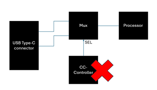

    Below is my use case:
    • I need to connect USB type-C connector with USB3.1 interface and do not need power from USB type-c as my device gets powered from adapter.
    • To interface the Type-C connector and use flip functionality, I am using Mux.
    I am need to understand what will be a challenged in below scenario:
    1. without CC-controller and with Mux
    2. Without CC-controller and without Mux (One of the SS lines of type-C will directly connect to USB3.1 interface)
    Shared reference block diagram image below.
    Nikunj
  • Hello Nikunj,
    Thank you for the elaboration, I am still waiting on a response from the design engineer.
    I am a MUX expert, not a USB one, but I think there will be no issues if you connect directly the SS lines to the interface.
    As I said I am still waiting on a confirmation from the designer if the mux can be used without a CC controller.
    I will relay their response as soon as I receive it.
    Nir
  • Hello Nikunj,
    Without the CC controller the flip feature wont be detected.
    The Mux's SEL input is driven by the CC-Controller after it determines the cable orientation. Without a CC-Controller, you have no automatic way to determine this.
    If the Mux is not switched correctly, your USB 3.1 SuperSpeed connection will fail 50% of the time (whenever the cable is flipped from the "correct" hardwired orientation).
    Also, for your second case by directly connecting only one set of SS lanes, your USB-C port will only work if the cable is inserted in one specific orientation. If flipped, the SuperSpeed connection will fail 100% of the time for that orientation.

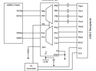

  • Thank you Nir for sharing the details and confirmation.
    can you please share the reference design suitable with my application along with CC controller?
    Nikunj
  • Hello Nikunj,
    I am not sure if we have reference design similar to your application, but you can find them under the product page in the Reference designs section.
    Here is the reference design for the HD3SS3212-Q1.
