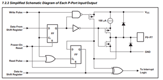

we are considering using the PCF8574A Remote 8-Bit I/O Expander and reading the datasheet following questions came up:
Is it allowed to have 3V3 on the P[0..7] IO-Pins while the supply voltage is removed from the VCC pin?
The absolute maximum ratings for VI say:
VI Input voltage range: –0.5 to VCC+0.5
Does this mean that having 3V3 on P[0..7] while VCC is 0V would exceed the maximum rating or is the maximum for VI always 6.5+0.5V=7V no matter if VCC is applied or not?
Background is that we want a way to reset the PCF857A by removing VCC but in this case the input voltages on P[0..7] would still stay at 3V3 at the time VCC is removed.

  • RK,
    This device doesn't have powered-off high impedance on the I/O pins.
    There is a diode from P0-P7 to VCC. Thus there will be back-powering into VCC when VCC = 0V and P0-P7 = 3.3V.
    This diode is removed in other I/O expander designs such as TCAL9539 for example. TCAL9539 removes the pin to VCC diode. The voltage on the I/O can be above the supply voltage to a maximum of 3.6V.
    Tyler
