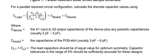

  • We build our EVM based on TI crystal user guide, which estimate Cboard and Cdevice separately,
    Cboard  is 3-6pf and Cdevcie is 2-5pf, typical  Cboard  + Cdevcie  = 8pf.
    If Cl is 20pf, then C1/C2 =( Cl-8pf) x2=24pf
    Best
