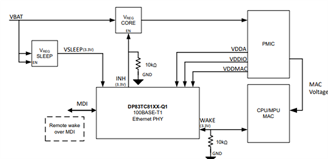

Hello Expert!
Nice to meet you.
I plan to introduce DP83TC812R-Q1 to my customer.
in this process, i have a question.
do they have to use LDO as shown in the figure below? Could they get VSLEEP (3.3V) from PMIC?
it means that why we use LDO in DP83TC812R-Q1?
Is this really necessary for sleep mode?
Thank you!!

    VSLEEP is the power supply for the PHY in sleep mode. A LDO is shown in the reference diagrams because in a typical application, VSLEEP would be provided by a low-power LDO that is separate from the LDOs that generate the other PHY power rails that are not used in sleep mode. This approach allows the other LDOs to be shut off and minimize the power consumption of the system while in sleep. But it’s also fine to power VSLEEP from a non-LDO 3.3V source, provided that it stays on while the PHYs are sleeping, meets the recommended operating conditions in section 6.8, and the rail includes the decoupling capacitor network shown in Figure 8-1. This approach has been implemented on some of our test boards for example.

    1. I'm curious specifically why using a separate low-power LDO reduces power consumption in sleep mode. Is this device blocking the input power sources(Except Vsleep) internally in sleep mode? Or like in the reference design, Do this device minimize power consumption in sleep mode by sending a signal to the PMIC to stop power delivery - cutting off power coming through Ethernet - and using a separate LDO ?

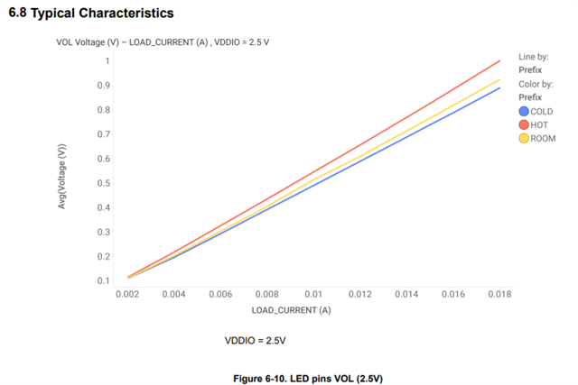

    2. Are these graphs correct for the 6.8 recommended condition you mentioned? If so, what current does load current refer to here?

    The operation of the TC-10 sleep/wake and interaction with other devices is fully described in the datasheet. In the expected usage, the INH pin output on the PHY is used as an enable input for the LDO(s) generating the normal PHY power supplies. When the PHY goes to sleep, INH goes low and disables the connected LDOs, while the independent low-power LDO stays on to provide VSLEEP. When the PHY is sleeping, it does not draw current from any of the non-VSLEEP power supplies, but disabling the corresponding LDOs leads to greater system power savings.
    In a typical automotive system it's expected that VSLEEP would be indirectly provided by VBAT. So an LDO would be needed in this case, and for an always-on LDO that is the source of sleep mode power consumption, a low-power LDO product is appreciated.

    These graphs are for the LED pins and unrelated. I realized I made a typo and meant to refer to section 6.3 for VSLEEP operating characteristics.

    Depends on the conditions. As I have already mentioned, we have implemented non-LDO 3.3V power to VSLEEP on test boards before, so that in principle can work. But if the generic 3.3 V source has poor stability, or if the decoupling capacitors are skipped, there is some risk of problems.
