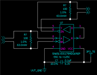

Hello.  The DS90LV804 is the function I need but it is only rated to -40C.   Is there a similar part rated to operate at -55C?   Actual use will be at -43C.   Thank you.

  • Hello Jack.  Here is the story.  This design is a test board designed to test a DUT.  The designers of the DUT changed the design low temperature requirement from -37C to -40C, and convinced those in power that we must design the TE to work at -43C.  +/-3C is a typical chamber tolerance.  In order to do that, I've used -55C rated parts.  However, the only part I found suitable as a clock repeater is the SN65LVDS179MDGKREP, connecting the receiver output (pin 2) to the buffer input (pin 3).   Hopefully the inline picture I posted will show.
    The problem with this I'm concerned about this circuit passing a 260MHz input clock.  I've asked a signal integrity SME if they can simulate this.
    An alternative, is to use a DS90LV804TSQ/NOPB but this part is only rated to -40.  No -55C part shows in a parametric search.  To do this I have two possibilities.   1) screen the parts to -43C operation or 2) obtain documentation that the parts are already tested with some margin.
    Thank you.
    Jeff
  • Hi Jeff,
    Thanks for the additional info. I share your concern regarding the 260MHz clock signal. That transceiver is only rated up to 200MHz.
    You are also correct that we do not have any buffers rated beyond -40C. If -55C is a hard requirement I would recommend SN55LVCP22. It is an LVDS crosspoint switch capable of being configured as a buffer. It can meet both your temperature and speed requirements.
