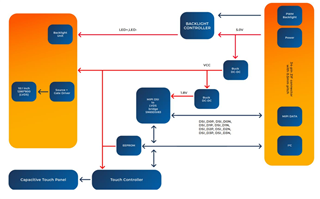

Hi TI,
We are using a "RVT101HVDNWC00-B" which used "SN65DSI83"  bridge, attached the block diagram and the data sheet for reference.
Below is the timing configuration which we have added:
static const struct drm_display_mode rvt101hvdnwc00_10 = {
    .clock = 71100,
    .hdisplay = 1280,
    .hsync_start = 1280 + 48,
    .hsync_end = 1280 + 48 + 32,
    .htotal = 1280 + 48 + 32 + 88,
    .vdisplay = 800,
    .vsync_start = 800 + 3,
    .vsync_end = 800 + 3 + 5,
    .vtotal = 800 + 3 + 5 + 22,
    .flags = DRM_MODE_FLAG_NHSYNC | DRM_MODE_FLAG_NVSYNC,
static const struct panel_desc rvt101hvdnwc00_10_10inch = {
    .modes = &rvt101hvdnwc00_10,
    .num_modes = 1,
    .bpc = 8,
    .size = {
        .width = 217,
        .height = 135,
    .bus_format = MEDIA_BUS_FMT_RGB888_1X24,
    .connector_type = DRM_MODE_CONNECTOR_DSI,
It will be of great help if TI team could help us to generate the complete Register list based on the provided data,as we are unable to get the register list generated from the Tuner application.
Also we have attached the  "SN65DSI83"  Driver code in which we have commented the sn65dsi83_host_attach function as the device dosent use command line video configuration. Please verify the modification and let us know if the chnages are valid.

Note: With this changes we are able to get card0 and card0-LVDS-1 nodes in /sys/class/drm. Also attached the modetest logs for reference

    1. For the DSI tuner, you can download it here: SN65DSI83: DSI TUNER tool needed - Interface forum - Interface - TI E2E support forums
    H
    ere's a guide for using this tool: https://www.ti.com/lit/an/slla332b/slla332b.pdf?ts=1746586623218
    2. To generate the I2C initialization, this is the information we would need:
    You shared the resolution display timings on your post. Could you please also share the DSI settings, and LVDS settings. If you send all the information based on your application and configurations, we can generate the I2C initialization script. Or you could also download DSI tuner and generate it.
    3. I am not familiar logs and driver code you sent. Could you tell me where you got these?
    The only driver for these devices we shared are on this thread: https://e2e.ti.com/support/interface-group/interface/f/interface-forum/546145/question-about-sn65dsi84/
    Thank you,
    Ikram

    we are using IMX93 custom board with RVT101HVDNWC00-B display.Below are the timing details we have provided in our code which are the same panel timing values:
    Timing Details:
        .clock = 71100,
        .hdisplay = 1280,
        .vdisplay = 800,
        .num_modes = 1,
        .bpc = 8,
        .size = {
            /* Assumed physical dimensions in millimeters; adjust these values
             * according to your panel’s datasheet if different.
             * Here we assume an approximate size for a 10.1" (16:10 aspect ratio)
             * panel: width ~218mm, height ~136mm.
            .width = 217,
            .height = 135,
        .bus_format = MEDIA_BUS_FMT_RGB888_1X7X4_SPWG,
    And Hear we have attached the I2C dump details:
    I2C dump logs:
    root@imx93Oraclemain:~# i2cdump -f -y 0 0x2c
    No size specified (using byte-data access)
         0  1  2  3  4  5  6  7  8  9  a  b  c  d  e  f    0123456789abcdef
    00: 35 38 49 53 44 20 20 20 01 00 85 10 00 01 00 00    58ISD   ?.??.?..
    10: 26 00 2b 00 00 00 00 00 78 05 03 00 00 00 00 00    &.+.....x??.....
    20: 00 05 00 00 20 03 00 00 21 00 00 00 20 00 00 00    .?.. ?..!... ...
    30: 05 00 00 00 58 00 16 00 30 00 03 00 00 00 00 00    ?...X.?.0.?.....
    40: 00 00 00 00 00 00 00 00 00 00 00 00 00 00 00 00    ................
    50: 00 00 00 00 00 00 00 00 00 00 00 00 00 00 00 00    ................
    60: 00 00 00 00 00 00 00 00 00 00 00 00 00 00 00 00    ................
    70: 00 00 00 00 00 00 00 00 00 00 00 00 00 00 00 00    ................
    80: 00 00 00 00 00 00 00 00 00 00 00 00 00 00 00 00    ................
    90: 00 00 00 00 00 00 00 00 00 00 00 00 00 00 00 00    ................
    a0: 00 00 00 00 00 00 00 00 00 00 00 00 00 00 00 00    ................
    b0: 00 00 00 00 00 00 00 00 00 00 00 00 00 00 00 00    ................
    c0: 00 00 00 00 00 00 00 00 00 00 00 00 00 00 00 00    ................
    d0: 00 00 00 00 00 00 00 00 00 00 00 00 00 00 00 00    ................
    e0: 00 00 00 00 00 01 00 00 00 00 00 00 00 00 00 00    .....?..........
    f0: 00 00 00 00 40 00 00 80 00 00 00 00 00 00 00 00    ....@..?........
    Kindly generate the I2C register details, based on this.
    Note: We have attached the display data sheet for reference
    Here is an initialization script for end-to-end video with DSI inputs:
    /cfs-file/__key/communityserver-discussions-components-files/138/CSR_5F00_0508.txt
    And here is a script for test pattern generation where the DSI83 device will product a test pattern for the LVDS channel without DSI input:
    /cfs-file/__key/communityserver-discussions-components-files/138/test_5F00_pattern_5F00_CSR_5F00_0508.txt
    Here are the settings I entered:
    Since the details you shared did not include the full configurations for DSI and LVDS, there are a few configurations I set freely. If the settings are different, then the initialization script register settings would need to be modified accordingly.
    - In the "Timing Details" you shared, the vertical back porch is 22, the datasheet says 23
    - The datasheet or your details page did not share horizontal/vertical sync polarities. I set them to positive
    - What is the LVDS clock rate?
    I calculated PCLK = Htotal * Vtotal * fps = 1448 * 831 * 60 ~= 72.2 MHz
    - What is the LP, burst mode, and sync mode settings for DSI that you are using? I couldn't find it in the details you shared so I set them as shown
    - Will the system use DSI clock or REF CLK as LVDS source? I set DSI Clock
    Please let me know if this works after you test and if you have any questions.
    Ikram
