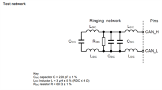

  • Hi Michael,
    Thank you for your reply and sending test network.
    The diagram is unclear and the text is unreadable.
    In particular, the text on the component constants is unreadable.
    Could you please send a clear diagram.
    Could you please also tell me the component constants used when measuring the ringing waveform of the SLLA581.
    Are they the LCR constants shown in the diagram above?
    I appreciate your great help and cooperation.
    Shinichi
  • Hi Shinichi,
    The image specifies the load as Csic 220 pF, Lsic 3 uH and Rsic 60 ohms. The components are the same as the ringing network (specified by CiA 601-4) mentioned in the app note, thanks.
    Michael.
