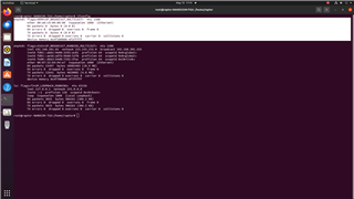

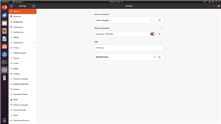

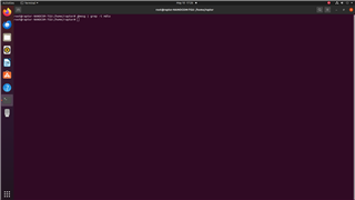

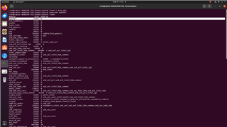

  • Hi Evan,
    That was very informative, We have done the above strap configuration but we are facing below issues:
    1)The link is not being established. Images attached FYR(Image1- enp3S0 is port related to DP83867CS).
    2) As per the app note suggested by you The below command doesn't throw any messages in terminal;
        dmesg | grep -i mdio
       But as per the app note, it should throw some error or should display the drivers linked. Image attached FYR (Image2).
    3) The port is being listed in ifconfig but not able to link. Image3 attached FYR.
    4) Does the Image4 mean something, For your information.

  • Hi Venkat,
    It seems the driver is compiled in your system, but not being loaded on start-up.
    "dmesg | grep -i mdio" is expected to show some messages relating to PHY probe attempt / detection. Even without PHY alive or driver imported properly, I still expect some MDIO probe attempt when Ethernet is enabled in device tree.
    Do you have Ethernet enabled in your device tree, kconfig, makefile, defconfig, ... ? Please review the driver integration appnote shared in my earlier reply and let me know any gaps in the steps relative to your system.
