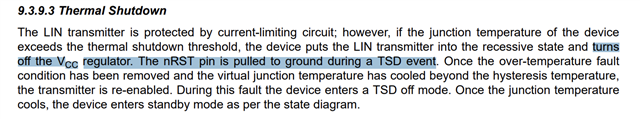

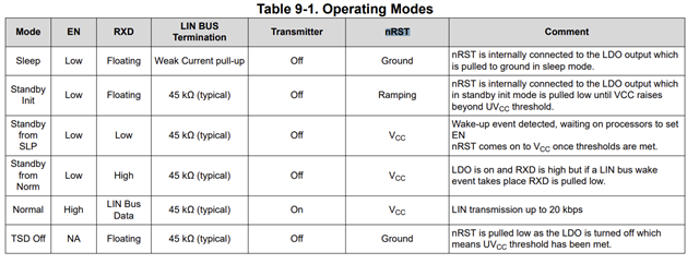

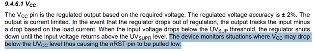

Dear TI experts,
My customer asked about the status of VCC and RESET in each cases. Could you check it?
1. In thermal shutdown case, what is the status of VCC and RESET?
2. In VBAT-LIN(p4) short case, what is the status of VCC and RESET?
3. in GND-LIN(P4) short case, what is the status of VCC and RESET?
Please check this issue. Thanks.
