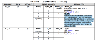

    Also, is RX_ER pin strapped so that signal detect is enabled?

    Could you verify that SD signal on the link partner is active high? If not, you will have to adjust the SD pin to be active low on the PHY side by writing 1 to bit 0 of the register 0x0465.

    ② Yes, I've written 1 to 0x0465. As I said before, the LED is already correctly showing if the fiber is inserted.

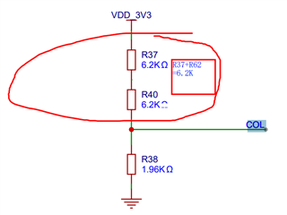

    I reviewed the schematic and I have some comments:
    1.
    I noticed that COL is meant to be strapped to mode 3, but it seems like this is not being strapped to the correct mode. Could this be changed to pull up to 6.2k?
    2. Could you put CRS into mode 4 instead of mode 2?
    3.
    Is SD pin connected to this? If so, could this be disconnected since SD pin will not function as LED1 in fiber mode?

  • COL is strapped to mode 3, because As I mentioned, R37+R40=6.2K,R38=1.96K
    ②I want to use 100 base-Fx, and PHY_ADD=1, so I need COL to use mode3

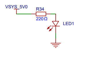

    ③SD pin is not connected to this, this is just a power indicator, this LED1 is the device name, not the network name. The LED1 of 822 is connected to the LOS pin of the SFP
    ④Currently in the sample stage, only one board is used for debugging functions.

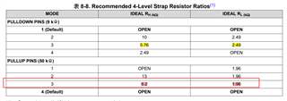

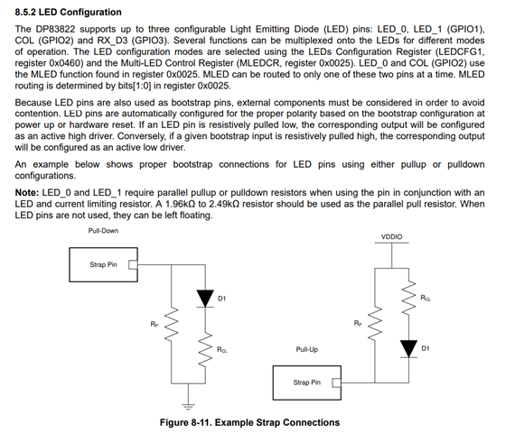

  • Hello, I have one last question about COL pin. Because I need to configure FX_EN=1 and PHY_AD0=1, I need to configure COL=MODE3, that is, RH=6.2k and RL=1.96K. After starting, I want to use it as a GPIO and drive the LED. May I ask how I should connect this LED without affecting the start of MODE3, whether it should be pulled up or down, and what should be the value of the pull resistance?
    thank you~

    Regarding your question, please follow the same recommendation as below:
    J
  • Thanks for the reply, the above figure is the reference of 2 level  strap, but COL pin is 4 level strap, but we have found the appropriate value through calculation and trial.
