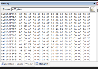

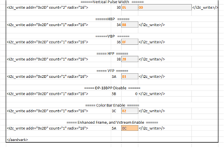

  • Hello Ikram,
    after Reset we confirm the Registers 0xF0-0xF8. After this, there is only the error LOSS_OF_DP_SYNC_LOCK_ERR.
    The Script of the DSI86:
    This is a dump of the Registers of the DSI86, starting with register 0x00 in the upper left corner:
