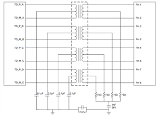

  • Hi David,
    Please check Attached Hardware schematic. Do i need any change in strap pin configuration for auto negotiation for 10 and 100 Mbps RGMII mode.
    Prasad
  • Prasad
    The strap configuration on the RX_CTRL pin controls the auto-negotiation enable and disable. You have to set the RX_CTRL pin to Mode 3 to disable and Mode 4 to enable auto-negotiation.
    To enable auto-negotiation, pullup is 5.76k and pulldown is 2.49k. I noticed in your schematic you have a 6.04k pullup, can you please change it to 5.76k?
    The LED_1 selects Auto-Negotiation Advertisement between 10/100/1000 and 100/1000. For 10/100/1000 advertisement, LED_1 strap mode is Mode 1 which is open. Please see below for the LED Mode 1 implementation. I noticed in your schematic the LED diode and 470ohm resistor is swapped and this needs to be fixed.
    Also looking at the integrated transformer and RJ45, you have the center tap shorted together and then pulled to ground through 0.01uF capacitor. We recommendation to keep each center tap on the side connected to the PHY be isolated from one another and connected to ground via a decoupling capacitor (0.1µF recommended) as shown below.
    Can you also dump out extended register 0x6E and 0x6F? This will verify the strap configuration is being done correctly.

  • Hi Prasad,
    As David said, strapping LED_1 pin to Mode 1 or 2 (depending on your preference on the RGMII TX Clock Skew) will select auto-negotiation advertisement to 10/100/1000.
    Enabling auto-negotiation itself is controlled by RX_CTRL pin and strapping that to Mode 3 will enable auto-negotiation.
    Your register dump already shows that auto-negotiation is enabled (bit 12 of register 0x0000 is 1).
    But it looks like auto-negotiation wasn't completed so link is not established.
    Please follow this table for recommended resistor settings:
    J
  • Hi J,
    Now My Hardware is working fine thanks for your help.
