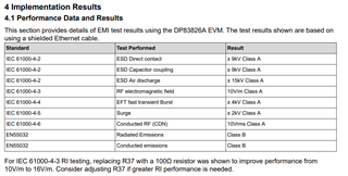

    Thank you. Jut a last question. Have ever been tested DP83826 for IEC 61000-4-5 (surge immunity) without additional protection diodes (that means magnetic + DP83826 only)?
    Jan
  • Hi Jan,
    The test results for the DP83826A EVM are shown in the DP83826AEVM User's guide:
    These tests were all performed with the ESD diode and magnetics on the EVM. Please note that in 'Class A' test passes, data was transmitted through the PHY during the test. This means the ESD diode was not actually triggering because data could still be passed through. In these tests, we expect the same result with or without the ESD diode.
    Shane
