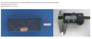

We have recently encountered the dimension of TS3USB221ARSER is different from past batches. Is there any PCN related or new updated Datasheet, or the findings are normal?
Referring to below   TS3USB221ARSER  (DC2505)
Measured result : 0.47 mm
Datasheet Specification : 0.5 ~ 0.6 mm

    Can you show me the top side marking of this device so I can look into this.
    There are no pcn changes that should affect the package size.
    Also has the device been damaged or chipped?( There is a brown mark on the bottom middle of the device image)
