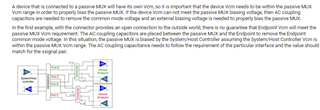

Hi team.
Customer is designing HD3SS3212 in their system. In CPU side, common voltage is 0V. But in endpoint side, it's 2.4 or 2.8V.
Question, which typology should be used for the AC Coupling Capacitors?
Figure 4 or figure 6 in datasheet?
Is below figure 4 works?
Thanks.
