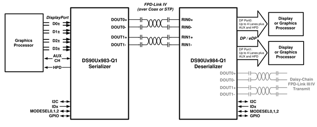

we are trying to send LVDS (D0 +/- to D3 +/-)data to serializer and deserialize(ds90uh984-q1) the data for 2 displays having both infotainment and cluster, it is possible.

Do you have a block diagram to make it more clear what the solution is needed here? Do you know the video resolution for the infotainment and cluster display?

we are trying to make the proof of concept sending LVDS data (4 pairs)from SOC to display( infotainment and cluster) having resolution of 4K. the LVDS data is sending through serializer(ds90uh983-q1) and deserializer (ds90uh984-q1) to the display. my quiery is both the displays are work simultaneously or anyone of it.

The DS90UH983-Q1 can only accept DisplayPort input, not LVDS. If the DS90UH983-Q1 receives a super-frame in SST mode or receives two video streams via MST then the DS90UH984-Q1 can be configured to output independent video on its eDP ports.
Both of the eDP ports on the 984 must run at the same link rate.
