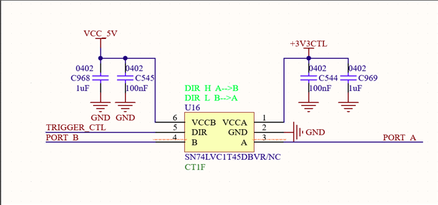

         We  design a level-shifting circuit using the SN74LVC1T45 to translate 3.3V level signals to 5V level signals from PORT_A to PORT_B as Figure1.The TRIGGER_CTL is 3.3V.The high-level voltage of PORT_B can only reach 4.7V but not 5V.Why does the high-level voltage of PORT_B only reach 4.7V instead of the expected 5V?
                                                                  Figure 1
