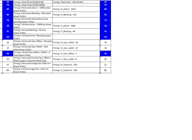

    Please share the display timings including pixel clock rates, DSI clock frequency and lane rates.

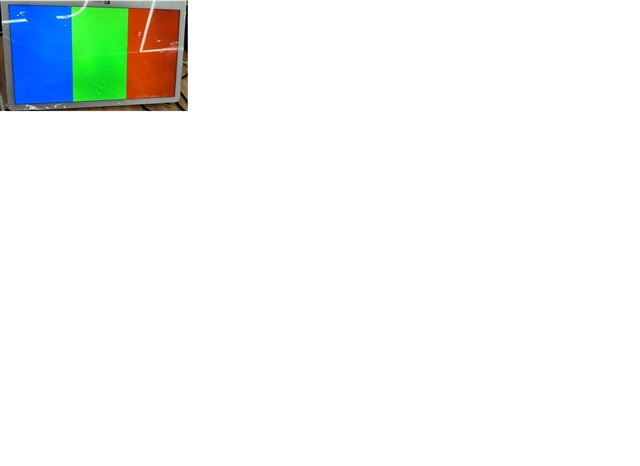

    1. We test with the test pattern with the REFCLK instead of MIPI CLK input.
    I want to make sure that the test pattern only can work with REFCLK, does it can work with MIPI CLK.

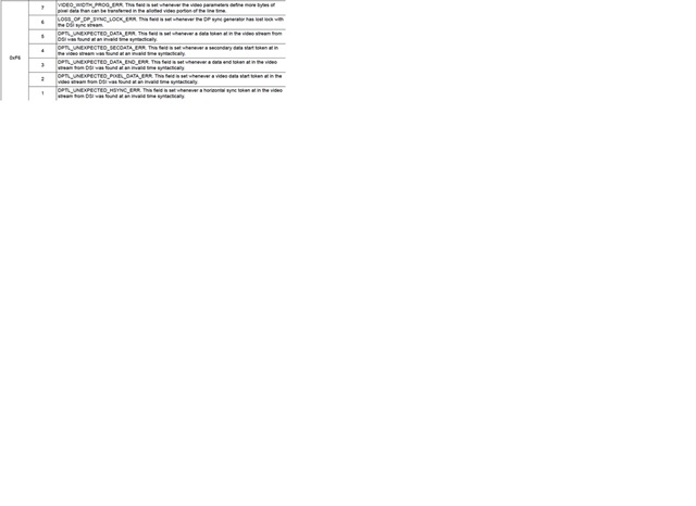

    We dump the register form 0XF0 to 0XF8, The 0XF6 BIT 6 is error, how can I solve it
    The design as below:
     I use MIPI_CLK instead of REFCLK and set the register through i2c as below, the 0xF0~0xF8 have not error

    1. With the color bar generator, the test pattern does not use the MIPI DSI clock.
    I would recommend using this calculator tool to generate the register settings for initialization. You can enable color bar/ test pattern, or use normal video input. And you can compare the script with the driver script to check whether the register settings match.
    Please use the calculator tool from this link to generate the I2C initialization script: https://e2e.ti.com/support/interface-group/interface/f/interface-forum/1382976/faq-sn65dsi8x-programming-tools
    2. With normal video with MIPI DSI input, you can use REFCLK or use MIPI clock. The REFCLK frequency would need to be set to the specific frequency for your video (check calculator tool).
