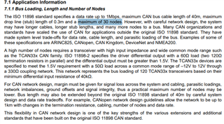

I want to make a device with 21 nodes, all with a TCAN337. All are connected on a same CAN bus with 120 Ohms at the beginning and at the end of the bus.
To you think this configuration is OK ?

Hi Yannick,
Yes, this is okay with node count less than 30, termination of 120 ohms at both ends, stub lengths as minimal as 10 cm or less will help minimizing reflections for signal integrity, total bus length of 2 m is also reasonable for CAN speeds, thanks.
