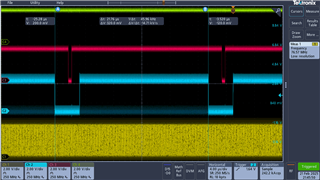

We deserialized the LVDS signals, and we discovered that:
  • The LVDS clock exactly matches the pixel clock frequency
  • Horizontal and vertical pulse witdh are the same as configured in DT
  • Horizontal and vertical back porch timings are as configured, together with vertical front porch
  • Horizontal front porch timing is NEVER respected, even when a certain configuration works, it's because the output is within the LCD tolerance.
  • By slightly changing the configuration (basically the LCD clock or some the other timings, still within LCD tolerances) we experienced unpredictable changes on the LCD signals, up to the VSYNC pulse disappearing completely.
Just as an example, in the following diagram the blue line (C2) is the DE signal, while the red (C3) is HSYNC.
HFP has been programmed to 48, HBP to 80. HBP is respected, while we measure HFP to be around 135 pixel clocks instead of 48.
Siince the Linux driver is taking care of configuring both the LVDS and the MIPI-DSI timings, we kindly ask if anyone ever experienced the same issue, or if you have hints on what could cause it or where we should investigate.

    The issues appears to be related to the line time requirement. According to SLLA356 and SLLA332B (SN65DSI8x Video Configuration Guide), "The line time (horizontal sync to the next horizontal sync) on the input must match the line time on the LVDS interface.".
    From my understanding, the statement implies that the SOC LCDIF pixel clock must be the same in the all chain up to the LVDS bridge. The kernel driver does not enforce the requirement and the match needs to be manual. In the kernel version in use, the PLL configuration in this chain may not allow a fine adjustment (while the hardware design allows it to be precisely tuned).
    What is happening here is that the processor makes use of a pixel clock that can be different (and in this case, it is) from the actual  DSI CLK clock that is used as a reference for LVDS pixel clock source (integer divider in the SN65DSI84). I was expecting the two pixel clocks to be interdependent, but I am measuring an actual pixel clock on the LVDS output that is different from the DSI pixel clock that I read back from the clock debug information from sysfs.  I was not expecting this to be possible and I am still investigating to have a better understanding of the clock paths within the SOC.
    With the sentence "the DSI8x does not realign timing, so if the line time is different then there will be issues.", is it possible that, under certain circumnstances, the IC may be just cause jittering on the sync signals and work or not depending on the tolerance of the LCD hardware?
    This difference in PCLK from SoC and Serdes would surely cause issues on output. Please align the serdes PCLK with DSI clock speed/PCLK from SoC for proper functionality.
    Yes, with misaligned timing the IC may cause jittering and if the misalignment does not fall within the LCD tolerance, then there may be no display altogether.
    Please try to see if you can align the timing and follow-up with the outcome.

    We confirmed that, for the clock speeds we were able to test, if the DSI and the pixel clock are corresponding, the image on the LCD is displayed correctly.
