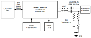

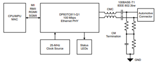

    We have one more clarification in DP83TC811(Though it is not recommended for new design). Can you clarify, what is the system (Number of transceiver) level difference between DP83TC811 and DP83TC813? because in documents related to DP83TC811, I could see 2/2 PHY transceiver but not in other variants of ethernet PHY ICs.
    Selva
  • Hi Selva,
    From a system perspective, all of our 100/1000BASE-T1 PHYs are point-to-point and have the same layout:
    So they each support a connection to one MAC device and a connection to one other PHY, on the TI.com product list I shared all PHYs are listed as "Single" for the "Number of ports" column. I'm not familiar with the "2/2 PHY transceiver" description for the DP83TC811 you mentioned, can you point out where you saw it? If it's a typo or ambiguity, I can ask our internal teams to review it.
