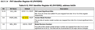

The datasheet of DP83848Q-Q1 states the Vendor Model is 0xA:
but the register reads 0x9.

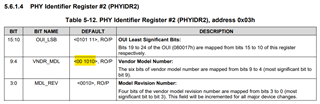

The datasheet of DP83848C states the Vendor Model is 0xA too:
Unfortunately I don't have a DP83848C to compare the register values.
I'd like to update a driver so that it automatically detects the part; C or Q-Q1. Could you please clarify the Vendor Models of the two parts, as it seems there's a typo in the Datasheets.
If the Vendor Models are the same, how else could I differentiate the two parts?

    I'd assume reading the "OUI - Vendor Model Number" registers would be enough to differentiate between the Q and C, or other possible models of the same family in case we have to change.
    I'd like to learn if the Vendor Model Number can be used and if yes, what are the values for each part.

  • Hi Ioannis,
    OUI Vendor Model Number are same for both devices so reading them will not differentiate two PHYs. OUI will be same for all TI PHY devices as this is IEEE assigned OUI number to TI. And Vendor Model Number are same for both devices.
    There are no differences in the register map between two devices, so I am not sure if there is a way to differentiate two PHYs on the software level.
