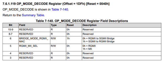

I am using the DP83869HM in bridge mode, with SGMII connected to the MAC and RGMII connected to the phy as shown below.
I am getting conflicting information on how to set the strapping on pin 38 to set the direction correctly.
Per the datasheet, pin 38 needs to be in mode 0 (open) for SGMII to RGMII mode.
However, from SNLA318 "Understanding different modes of operation in DP83869", it says to set pin 30 to mode 1 (pull-up to VDDIO).
Can you let me know what is the correct pin strapping? I know there several descriptions of the register settings for this in other forum posts, but I am the hardware designer and I want to make sure the resistors are correct without having to make register changes.
Would you also update whichever document is wrong to avoid problems like this in the future?

    I tested this in the lab on the DP83869EVM. I'm seeing RGMII to SGMII bridge mode with Pin 38 pulled up. When the pullup is removed, the op-mode is SGMII to RGMII.
    I used register 0x01DF to determine the mode of operation. With the pullup present, this register was 0x0003. With the pullup removed the register is 0x0043:
    The datasheet is correct here. I'll look at getting that app note updated in the future.
