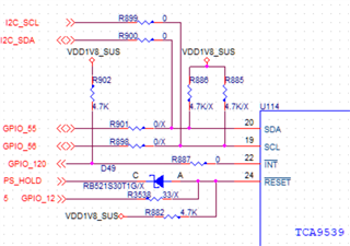

Hi Team,
I found that sometimes pin24 RESET- this pin is sometimes disturbed (ex. external chamber switch),
This causes the IC to enter the reset state by mistake, clearing the originally set GPI/GPO state.
In our experiment, if we change R882 from 4.7K to 0ohm, it will not trigger reset by mistake.
I just wonder if there might be any other problems?
