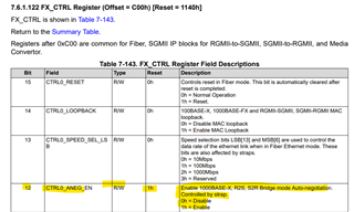

I'd like to confirm some settings regarding Auto Negotiation OFF.
I set like this to turn off the Auto Negotiation.
GEN_CFG2 Register (Offset = 14h) [set = 2947h].
It means that GEN_CFG2[7] SGMII_AUTONEG_EN set "0".
Is that correct, enough and meet the Clause 37?
If I need more settings, please share that.
